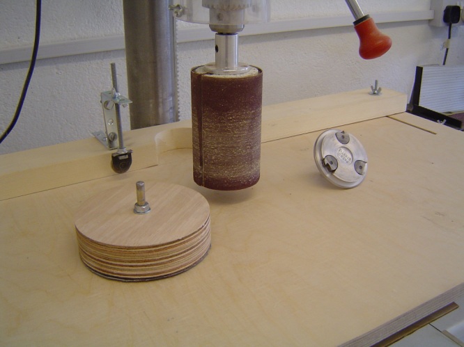

Terry, I use my drill press for a lot of functions, even drilling! Although I still like using a hand plane a lot of my thicknessing takes place using the safety planer and drill press sander, especially neck thicknessing. I use it as a spindle sanding set up, both with the large drum and with the robosander fro fine copy work. With the table router and band saw it is the most used tool in my shop.
PostPosted: Mon Apr 24, 2006 7:24 am
Collin, I am about to make a couple of the sanding disk you use. From the image above, it looks like you relieve the outer edged of your disk, is this just an optical illusion, a slight arris, or an extended curve of the lip if that makes sense?
Cheers Kim

Hey Colin, How do you like the functionality of that drum? What weight paper do you use? What are the pros and cons of that type drum (Standard paper sure is a plus!)
Thanks for the pic

Kim, yes there is a slight angle on the edges of the disk, just helps with the infeed of timber, I sand down to 1mm thick using this and you don't want thin timber hanging up on an edge. I just use two layers of 19mm ply the top one drilled right through and the bottom one just relieved for the internal nut and washers. Insert and tighten the bolt and it's nuts then glue together. Stick self adhesive velcro hooks to the bottom and your ready. I have a number of them ready made up with different grits.
Terry, I love the big bobbin sander, It's got a cam lock for changing the loading. I cut up the heavy cloth backed abrasives made for a belt sander and they give a good length of service if cleaned regularly with the rubber belt cleaner. I use 80, 120 or 180 grits according to the job.

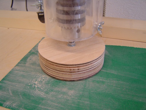

Kim, as you say, I sand the disc flat using the table, like this:
Then just wipe it clean and add the self adhesive velcro hooks, I get it in 6" wide rolls. It has never even looked as if it would come loose.

I see on your bobbin sander a groove where you push and insert your cloth backed abrasives, do you also glue the abrasive to the bobbin cylinder or that groove or recess is enouh to keep the abrasive on the bobbin ?

Serge, the bobbin has a hole bored down it, that the abrasive is pushed into, an oval rod is pushed down and twisted to lock the abrasive in place.
